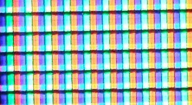

Anyway i found more about my panel type:
http://jishu.95105555.cn/Article/Upl...0717233625.xls
AUO cell? AMVA?
3D extremely narrow 46E330E 8R51 42WH04 Specifically for the machine TPV screen LCA460HVD02A09030X (AUO Cell) TPT460H1-HVD02 0F0B
Attached a picture from pixels of my panel. It doesn't look like AMVA to me, more like IPS or Sharp MVA (Blue/Green/Red).

Прикачен файл 13587
[QUOTE = hristoslav2; 678 171] Look lile - MVA. [/ QUOTE]
