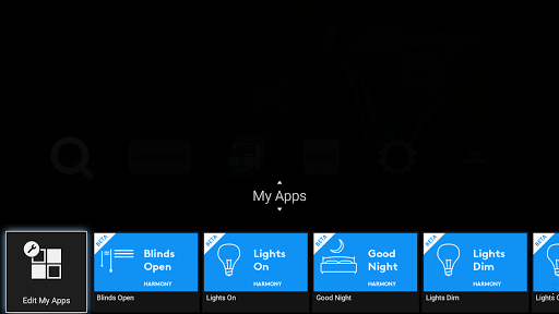

New Harmony app lets Sony Android TV control the smart home - FlatpanelsHD
Google Play store...Logitech Harmony for TV
https://lh3.googleusercontent.com/1y...R6SfJU4J1sb6Jc
https://lh3.googleusercontent.com/Md...X0nbjTj8CdsDog
http://www.flatpanelshd.com/pictures...nysonytv-2.jpg
http://www.flatpanelshd.com/pictures...nysonytv-3.jpg
source photos:[flatpanelshd.com,Google Play store]
