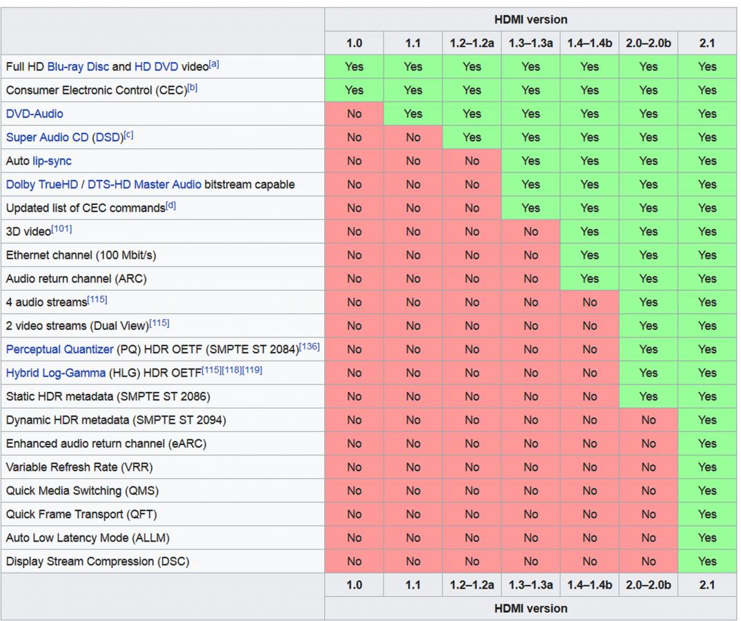

    Благодаря за линка. Както казах знам какво е, за какво служи и каква е разликата между ARC и eARC. Продължавам да мисля че говорим за различни неща оттам идва и объркването.
    Аз се хванах за изказването - " за трансфера на DTS-HD, Dolby True-HD ти е нужна поддръжка на eARC от двете устройства " което не е вярно. Вие през цялот време говорите за HDMI ARC и HDMI еARC.
    ARC и еARC са функции на HDMI които можете да ползвате или не. От 1.3 нагоре по спецификация (не по шаманство) HDMI може да пренася DTS-HD, Dolby True-HD
    Version 1.3
    HDMI 1.3 was released on June 22, 2006, and increased the maximum TMDS clock to 340 MHz (10.2 Gbit/s).[6][38][95] Like previous versions, it uses 8b/10b encoding, giving it a maximum video bandwidth of 8.16 Gbit/s (1920 × 1080 at 120 Hz or 2560 × 1440 at 60 Hz). It added support for 10 bpc, 12 bpc, and 16 bpc color depth (30, 36, and 48 bit/px), called deep color. It also added support for the xvYCC color space, in addition to the Rec. 601 and Rec. 709 color spaces supported by previous versions, and added the ability to carry metadata defining color gamut boundaries. It also optionally allows output of Dolby TrueHD and DTS-HD Master Audio streams for external decoding by AV receivers.[96] It incorporates automatic audio syncing (audio video sync) capability.[38] It defined cable Categories 1 and 2, with Category 1 cable being tested up to 74.25 MHz and Category 2 being tested up to 340 MHz.[6](§4.2.6) It also added the new type C Mini connector for portable devices.[6](§4.1.1)[97]
    Feature support
    HDMI version
    1.0 1.1 1.2–1.2a 1.3–1.3a 1.4–1.4b 2.0–2.0b 2.1
    Full HD Blu-ray Disc and HD DVD video[a] Yes Yes Yes Yes Yes Yes Yes
    Consumer Electronic Control (CEC)[b] Yes Yes Yes Yes Yes Yes Yes
    DVD-Audio No Yes Yes Yes Yes Yes Yes
    Super Audio CD (DSD)[c] No No Yes Yes Yes Yes Yes
    Auto lip-sync No No No Yes Yes Yes Yes
    Dolby TrueHD / DTS-HD Master Audio bitstream capable No No No Yes Yes Yes Yes
    Updated list of CEC commands[d] No No No Yes Yes Yes Yes
    3D video[101] No No No No Yes Yes Yes
    Ethernet channel (100 Mbit/s) No No No No Yes Yes Yes
    Audio return channel (ARC) No No No No Yes Yes Yes
    4 audio streams[115] No No No No No Yes Yes
    2 video streams (Dual View)[115] No No No No No Yes Yes
    Perceptual Quantizer (PQ) HDR OETF (SMPTE ST 2084)[136] No No No No No Yes Yes
    Hybrid Log-Gamma (HLG) HDR OETF[115][118][119] No No No No No Yes Yes
    Static HDR metadata (SMPTE ST 2086) No No No No No Yes Yes
    Dynamic HDR metadata (SMPTE ST 2094) No No No No No No Y
    За това по - простичко казано , може ли да възпроизведем Dolby True-HD използвайки функцията ARC - категорично не,
    можем ли да трансферираме и възпроизведем Dolby True-HD по HDMI без eARC - категорично да, и го правя. С удоволствие бих ви демонстрирал на по бира , ако имате път към Пловдив.
    Поздрави
