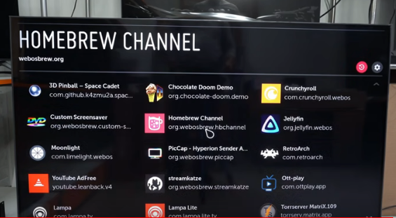

    С рут не става ли?
    Имат някакво тяхно приложение без реклами.
    Стъпки:
    just adding my experience with rootmy.tv :
    -no need for LG developer login/sdk download
    -visited rootmy.tv
    -rooted tv
    -uninstalled official youtube app
    -installed adfree youtube from Homebrew Channel
