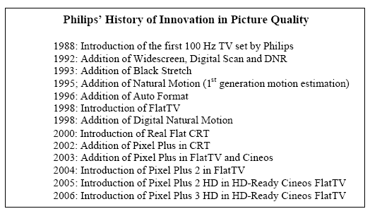

  Еволюцията на Natural motion и Pixel plus
 http://forum.ixbt.com/post.cgi?id=attach:62:14399:72:1
 http://forum.ixbt.com/post.cgi?id=attach:62:14399:75:1
http://medienservice.philips.de/apps%5Cn_dir%5Ce1231501.nsf/pages/646B413978331745C125713E005E8648/$FILE/HDTV_whitepaper_Feb+2006_engl.pdf
 http://www.docstoc.com/docs/1745431/...0white_20paper
