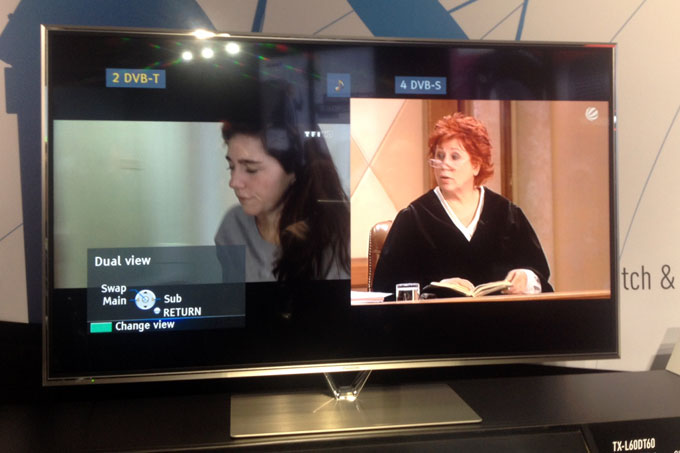

    Twin HD Tuner в модели 2013 - подробности
    Google Translate
    TX-P65ST60 (65in model not coming to Europe/UK) ???
    http://www.whathifi.com/news/panason...-release-dates
    http://www.flatpanelshd.com/news.php...&id=1361272859
