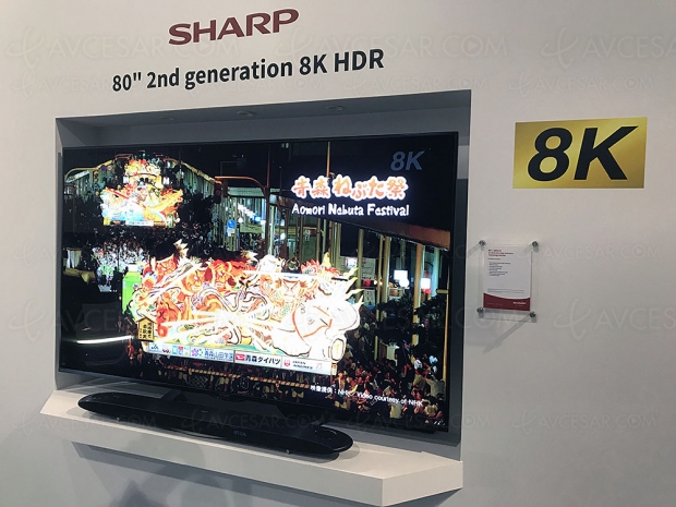

    Background - 8K TVs at the IFA 2018
    https://tweakers.net/reviews/6513/3/...tv-vestel.html
    планиран за март 2019 г.
    Sharp 8T-C60AX1
    Sharp 8T-C70AX1
    Sharp 8T-C80AX1
    https://www.avcesar.com/actu/id-2535...-annonces.html
    source photos:[tweakers.net,avcesar.com]
